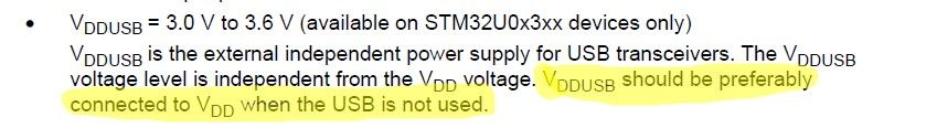

I am planning to use STM32U083CC series MCU in my project and after inspecting datasheet there is a line "Vddusb should be preferably connected to Vdd when the USB is not used)". I know that Vddusb is independent from Vdd but is it omitted that i can not use Vdd for Vddusb? I mean should i need extra AMS1117 3.3 for instance to feed Vddusb?VDD USB.jpg

If your main VDD supply is within the USB operating range (typically 3.3 V), it is acceptable and common to connect VDDUSB directly to VDD.If your application requires the MCU to operate at a voltage lower than the USB transceiver’s minimum (for example, below 3.0 V), you must provide a separate 3.3 V supply to VDDUSB
You can refer to AN4879 power section

Have you seen Application note AN5938Getting started with STM32U0 MCUs hardware development ?

It seems i need to supply it without using Vdd not to reduce current supply capacity of MCU. Its a little hard for me. I need to supply MCU, and i need Vref voltage for ADC and Vddusb. Three independent supply source i need.

It make sense now. I need to operate MCU at Low Power Mode. So, it will probably need externall supply if i use USB. Tahnk you for helps.
