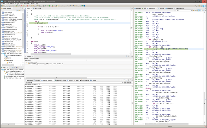

I try to build a code example where I can execute directly from external OctalSPI flash.
I use HAL project "XSPI_NOR_MemoryMapped_DTR" as reference and starting point:
It works fine: I can write (flash) and read back external QSPI memory. I can also execute code from it.
It looks to me at: the memory region 0x7000_0000...0x7000_00FF on external OctalSPI is a "write and readable" data region but "never an executable region". Code execution is only possible at address 0x7000_0100 (and beyond).
The strange issues I have:
- without MPU configured: I can write (flash) data on 0x7000_0000... It works fine: read back in code seems to be OK.
In debug mode, using the "Memory Browser" : I see this region 0x7000_0000...0x7000_00FF written properly - all written and read back are correct - with MPU enabled (for this region): I can still write and read back - all OK (FW passed on reading it back).
BUT: in debug mode, using the "Memory Browser" : I see this regions 0x7000_0000...0x7000_00FF all as 0xFF.
(even the write and read back via FW code passes) - When I try to call the code written to OctalSPI flash memory (0x7000_0000...0x7000_00FF) - I write data as instructions, a very simple sub-function called with:
movs r0, #1
bx lr
(in hex value as 0x2001 0x4770)
I can never call this code at address 0x7000_0000. But I can this call this code located at address 0x7000_0100.
So:
- enabling MPU makes it impossible to read what was written at 0x7000_0000...0x7000_00FF in Memory Browser (all as 0xFF), but code running seems to see properly written values and able to read it back.
- I can never call the code at 0x7000_0000, never mind if MPU is enabled or not - just code starting at 0x7000_0100 works.
The difference is on main() - with or without calling MPU_Config():

So,
- enabling MPU makes it impossible to use debug "Memory Browser" to see the content on OctalSPI 0x7000_0000... (but code running seems to see properly)
- I can never jump to 0x7000_0000 (+1), but jump to 0x7000_0100 (+1) works
Are the first 256bytes on external OctalSPI flash always never executable?
Why does MPU config "hides" this memory region? (in debug mode with MemoryBrowser)

‎2025-01-03 4:28 PM
Here my debug session:
- see: region 0x7000_0000...0x7000_00FF is displayed as 0xFF
- calling code at 0x7000_0100 (+1) works
‎2025-01-04 12:59 AM - edited ‎2025-01-04 1:12 AM
Isn't it the place where the STM32N6 expects the binary "signature" using STM32_SigningTool_CLI.exe? And the offset shall actually be 0x400 (1kB)? Because that's the size of the signature. So it is maybe unreadable/unusable by design or something like that?
‎2025-01-04 6:14 AM
Hi @tjaekel
The XSPI_NOR_MemoryMapped_DTR example demonstrates how to erase, write and re-read data in the external NOR Flash.
Normally, for a code execution context from this external XPI Flash memory, you should start from the Template_FSBL_XIP example.
Both FSBL and Appli binaries must be signed before programming (refer to the example readme.html)
