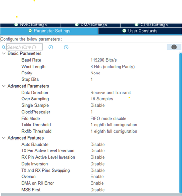

I am using USART4 in STM32L562E-DK eval board. with given configuration.414D414E_0-1757398146959.png
In which I am able to transmit the data correctly on TX based on which UART slave device is sending back the 4 bytes ACK and 16 bytes RESPONSE.

> If I am reading only 4bytes of data what happens to remaining data is it loss?
If you don't read out a byte before a new byte comes in, an overrun occurs and the new data will be lost. The peripheral will need to have the OVR flag cleared before it will receive new data.

> Will I need to clear OVR flag manually after reading 4 bytes.
Are more bytes coming in which you aren't ready for?
HAL_BUSY indicates the peripheral is already waiting for data. You shouldn't be calling HAL_UART_Receive_IT more than once until it finishes.

If the slave is sending in packets, then use HAL_UARTEx_ReceiveToIdle_DMA and HAL_UARTEx_RxEventCallback for idle event.
On each packet sent, there will be an idle state which will interrupt. By using a queue, you can separate each packet in it's own queue for easing processing. If you don't want to use DMA, you can use HAL_UARTEx_ReceiveToIdle_IT without DMA.
See this example project https://github.com/karlyamashita/Nucleo-G071RB_UART_DMA_Idle_Circular/wiki

Can i see the size of rxbuffer4? and if you clear the index? if index more than size , will it receive(handle the data) the data read, so i think you can have a fifo, as soon as data come, you just read it to fifo, and have a process in main while and deal those data in fifo, in this case you will not omission any data.
