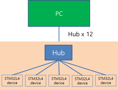

> However, the maximum of 60 is not connected to the PC or laptop, and the device is not recognized with an exclamation mark in the device manager.
So you're not connecting something, and then nothing happens, and you want to know why? I suspect typos in your question. Unclear what's happening.
Max devices is 127, including hubs, and there is a maximum hub chain length.
‎2025-03-13 9:20 AM - edited ‎2025-03-13 9:22 AM
Generally, without any connection to STM32, Windows can support very large number of serial interfaces. Their names no longer have to be "COMn". A Windows machine can have several USB host controllers, each of them can connect up to 127 USB physical devices (including hubs), each device can have up to 255 composite functions. So you have a plenty of room to play ))

‎2025-03-13 7:46 PM
Well, the STM32L4 is not a hub. But it could be a device.
Do you have 60+ USB devices hooked up to the PC? How many layers of hubs does that entail? Might be exceeding things there.
‎2025-03-13 10:01 PM
As shown in the figure above, I made a device using the STM32L4 CPU.
I connected these devices to a hub commonly sold on PC and laptop, and connected about 60 STM32L4 devices.
An exclamation mark appears in the device manager and it is no longer recognized as a Com port.
I want to know why the number of Com ports connected in the device manager is different for each PC.
