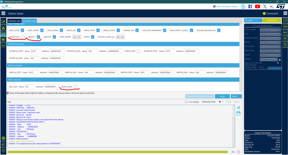

Now, my STM32C092 mcu has nBOOT_SEL bit just cleared in Opton Byte and my simple led blinking application is running. If I keep BOOT pressed while I press and release RESET, my led blinking app still start running and STM32CubeProgrammer does not connect with the target.

With STM32CubeProgrammer through ST-Link I verified:
  • BOOT_LOCK(bit) = 0 (it is the default value)
  • nBOOT1(bit) = 1 (it is the default value)
  • nBOOT_SEL(bit) = 0 (cleared by me)
 So, why System Bootloader does not start when I reset the NUCLEO with BOOT pushbutton pressed?
