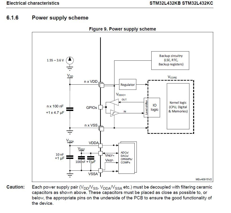

STM32L432 in UFQFPN32 package. In the datasheet, it`s not clear defined, how the analog ground is connected to the internal Ref and ADC ?
Volker Bremauer
Here definition from the datasheet, but in the 32pin package there is no VDDA !
Is any VSS also the VSSA ?
1 REPLY 1
waclawek.jan
I assume that only one of the VSS pins is connected to VSSA/VREF-. The DS ought to say so. @Imen DAHMEN​ , can this please be clarified in the DS?
