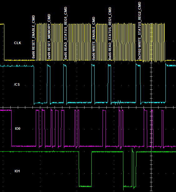

I have found the problem in the QSPI initialization,
Thanks for your help
 hqspi.Instance = QUADSPI;
 hqspi.Init.ClockPrescaler = 255;
 hqspi.Init.FifoThreshold = 1;
 hqspi.Init.SampleShifting = QSPI_SAMPLE_SHIFTING_NONE;
 hqspi.Init.FlashSize = 1; --> must be 0x18;
 hqspi.Init.ChipSelectHighTime = QSPI_CS_HIGH_TIME_1_CYCLE;
 hqspi.Init.ClockMode = QSPI_CLOCK_MODE_0;
 hqspi.Init.FlashID = QSPI_FLASH_ID_1;
 hqspi.Init.DualFlash = QSPI_DUALFLASH_DISABLE;

JSanz.1
Thanks for your early answer,
All seems to work, I been wrote '0xbebacafe' string into the first four flash bytes ok, and read the status ok, and move to on line as you suggest, it seems to do the same, only read four bytes at zero address if only read four bytes.

I joined a plot of initialize function, it looks like everithing is ok, there are signals in all wires
