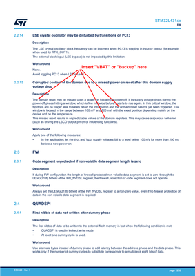

STM32L431 Errata: VBAT brownout erratum confusing wording: missing "VBAT" or "backup"

Hi @waclawek.jan
Thanks again for bringing this issue to our attention.
I confirm the issue and I reported internally.
Internal ticket number: 167452.
 PS: 167452 is an internal tracking number and is not accessible or usable by customers.
