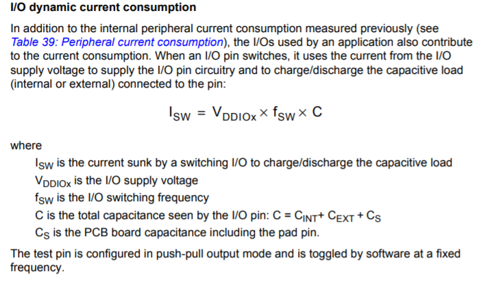

0693W00000HomlwQAB.pngI find some information in datasheet: https://www.st.com/resource/en/datasheet/stm32l422cb.pdf.
Hope it helps.
Vb.11
Sco,
Not getting what exactly is details.
My specific requirement is about current consumption when proximity detection is on in lower power saving mode.
As my application is battery operated this feature has highest importance.
