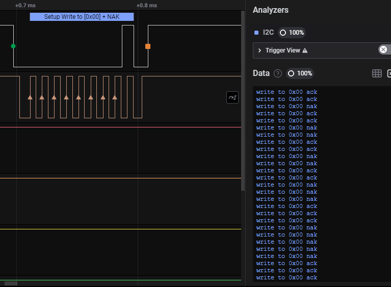

hello,
i am trying i2c to communicate two stm32f103c8t6 . It is not working. logic analyzer output is shown in picture.
what can be done for i2c to communicate two stm32f103c8t6
address 0x00

0x00 shouldn't be used as a slave address as it's a general call address. The logic analyzer plot is otherwise a valid I2C signal. If the slave is not responding, it's probably a code issue. Although it seems like it is responding about every other time, so this suggests the slave is not ready when the master sends the message.

Hello @SSaya.1​ ,
I advise you to have a look at this FAQ: STM32 I2C does not work, which describes few tips related to I2C peripherals.
I suggest also to check the I2C example available in STM32CubeF1 MCU package and compare your own code/configuration to identify what is going wrong with your project.

thank you, I2C worked, i had no idea about I2C plotting by logic analyzer before
