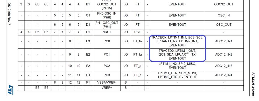

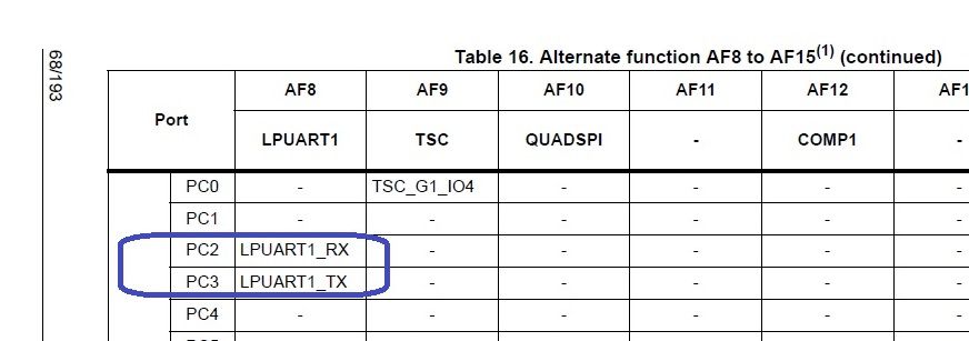

STM32L412 Documentation Anomaly
‎2020-08-07 10:20 AM
AF pin assignments internally inconsistent in product datasheet.
Need clarification of actual hardware configuration.
STM32L412RB Data Sheet
https://www.st.com/resource/en/datasheet/stm32l412rb.pdf
https://www.st.com/resource/en/datasheet/stm32l412c8.pdf

Thanks for that.
CubeMX thinks PC0/PC1 are LPUART too, which is good because that's what we used on the PCB
The L452/L462 have this AF table making more sense
‎2020-08-08 12:19 AM
Just for info - it's PC0, PC1 and consistent on L431 and L433.
