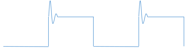

Hello Jan,
Slope setting of I/O pin impacts speed of signal switching from low to high and from high to low on the pin. For low-frequency signals it is enough to set low speed, while for high frequency signals it is recommended to set this speed to higher value.
Some time ago I made an exercise with outputing different clock signals on MCO pin and capturing them by scope. I noticed that for LSE (32.768kHz) shape of the signal was the best when slope setting was set to low. For different settings I observed something like overshoot shown below.
These other settings (medium, high and very high) are better for high frequency signals. For example when MCO outputs System clock set to 80MHz (PLL). Then very high speed is appropriate (if IO speed would be set to low or medium when MCO outputs 80MHz clock, then there would be no signal on the pin, as signal would be changing faster than IO is able to switch).
As a result my conclusion from the exercise was that it makes sense to set low IO speed for low frequency signals to avoid overshoots and high IO speed for high frequency signals to keep IO switching fast enough for outputing the signal.
Regards
Szymon2018-03-17 09:27 AM
Szymon,
Sure, for most of the applications, the output slew rate has to be set to the (s)lowest viable setting, to reduce EM emissions and limit/avoid the various HF effects on signal and power and ground. But here we want to measure the period of 32kHz signal with possibly 100ppm resolution, that's around 3ns. The max. rise/fall time for the 'L4xx for a 10pF load at 3V supply is given as 17ns for the 'low speed setting' (OSPEEDR=0b00) and 2.5ns for OSPEEDR=0b While you can argue that measuring time between the same voltage level in a two successive rising edges eliminates much of the error, yes it does, but still with lower drive the output is more prone to interferences and noises, so you are always better off in this particular regard when going to higher drive.
So, while still generally is LOW setting appropriate for a 32kHz signal, in this particular case, I personally would rather set it HIGH and then investigate and mitigate the cause for overshoot and ringing - which more often comes from the imperfect tools used for measurement (e.g. poor oscilloscope probe grounding/coupling, overcompensated divider probe) than materially existing in the measured signal.
