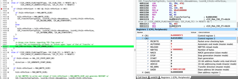

I recently update my STM32L4 HAL library from 1.9 to 1.13.  After that, using the
HAL_I2C_Mem_Write_IT
function, I got stuck in an error routine because TCR flag was set and that shouldn't happen:

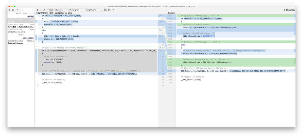

When I looked at the changes in the HAL library, I saw that the HAL function changed the transfermethod to RELOAD
instead of the AUTOEND that it used in the old library version when the amount of bytes was less than 256:
I think this is a mistake. The I2C transfer should always be using AUTOEND
unless the amount of bytes exceeds 255.

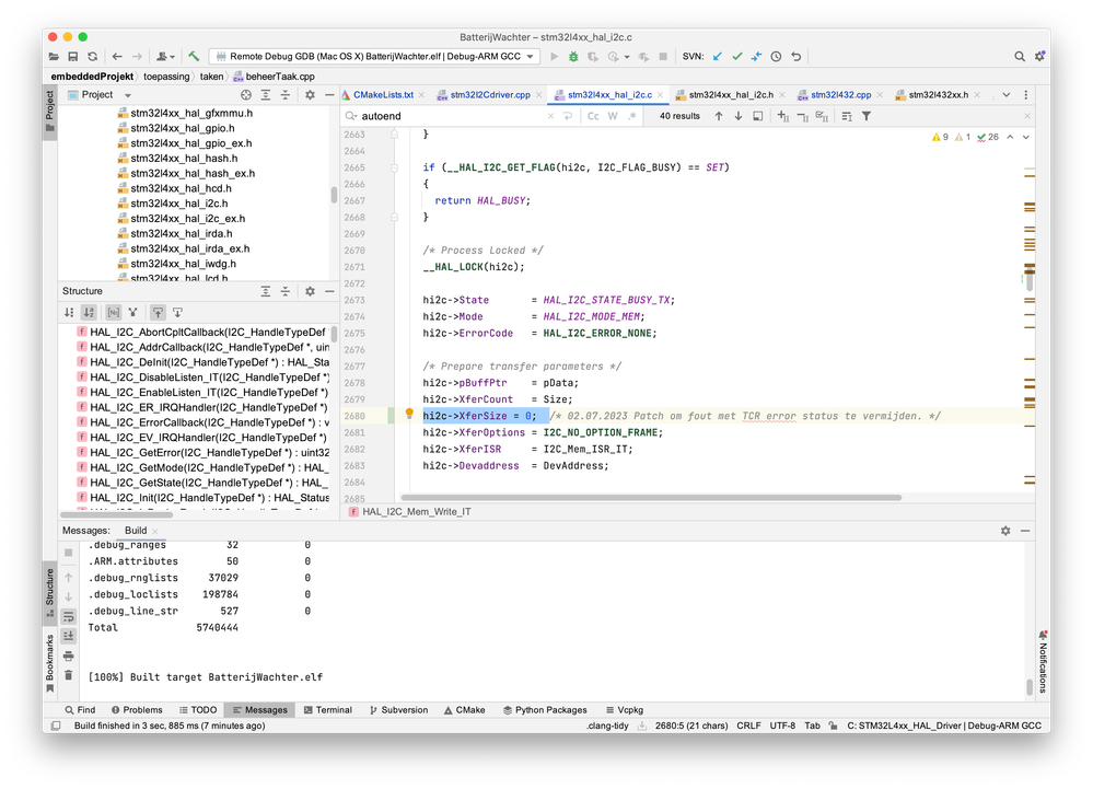

I applied a fix to the driver by setting the XferSize member variable to 0. Doing this made the ISR routine perform without any errors, and my application runs again without problems.:
Schermafbeelding 2023-07-02 om 17.43.08.pngI reckon this fix, if valid, should also be applied to the the HAL_I2C_Mem_Read_IT function.

onderdelen
Thanks for your reply. My take on it is that the XferSize variable holds a value after an I2C transfer. Then, when doing the next transfer the old value would be in the way and interfere with the new setup in the HAL function, which splits the transfer in a few parts using the RELOAD feature of the I2C hardware. The reset of XferSize to 0 is required.
