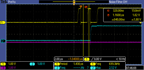

camila
Posted on February 13, 2014 at 10:41
Yes, the LCD gets its power from the Discovery.
delay(20) takes about 0.2ms. I also have a 0.1ms delay in between the call to i2c_init() and lcd_init(). In addition, I don't think this should be a problem because I'm currently stepping on each statement, so this should give enough time for the uC to properly reset the LCD.
When I look at the oscilloscope, this is what I see after the call to I2C_Send7bitAddress(I2Cx, deviceAddress, I2C_Direction_Transmitter);
Where yellow is the SCLK, blue is SDA and purple is the active low reset of the LCD (in the screenshot high, since this is after the reset).
Any guidance on this would be very helpful.
Thank you.
chen
Posted on February 13, 2014 at 11:19
Hi
The trace only shows 2 bits being transmitted. not sure what is going on. Try running the code upto ''

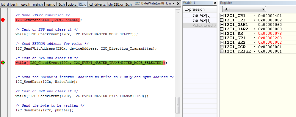

camila
Posted on February 13, 2014 at 11:35
I believe that until the while the configuration is correct. Here is a screenshot of the registers.
Are you asking about the value defined for
I2C_EVENT_MASTER_BYTE_TRANSMITTED,
if that's the case it is defined as I2C_EVENT_MASTER_BYTE_TRANSMITTED                 ((uint32_t)0x00070084)
Thanks!
chen
Posted on February 13, 2014 at 11:59
Hi
As I said before I cannot tell what is going on until I see the start bit and address byte being transmitted.
The trace only showed 2 bits transmitted - very strange!
And then a stop bit.

chen
Posted on February 13, 2014 at 12:21
''The screenshot that I sent from the scope is after the I2C_Send7BitAddress...''
Then something is very wrong.
The trace only shows 2 bits being sent (only 2 SCLK cycles) and then what looks like a stop bit.
Try to capture the whole 9 bits of the address byte!
stm322399
Senior
Posted on February 13, 2014 at 13:22
Is this likely that speed being too high locks the I2C IP ?
The capture shows that freq of SCL is near 700KHz, which is way over the 400 KHz max.
camila
Posted on February 13, 2014 at 14:31
I'm not sure how to get the entire clock sequence. I switched to ports 8 and 9 (clk and sda respectively), but still the same issue. I also changed the GPIO speed for both of them to 400KHz.Nevertheless, the frequency shown on the scope is still 700KHz, how can I change this?
