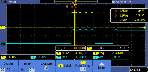

OK I divided the I2C clock speed by 2. Now I see the whole clock and data after sending the I2C_Send7BitAddress. Still it gets stuck on the EV6 flag check.
This is the screenshot of the scope.

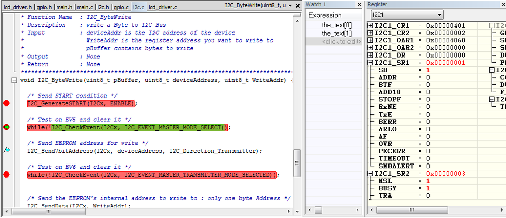

Registers status after sending GenerateStart:

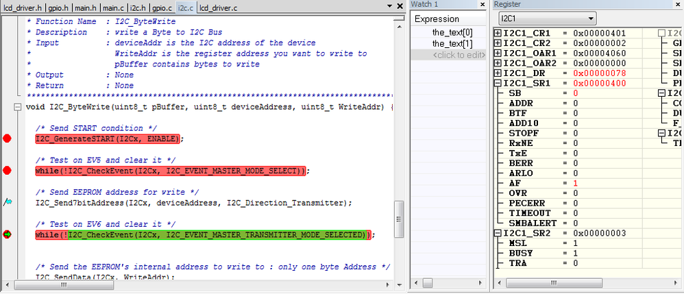

Registers status after I2C_Send7BitAddress:

Well, I2C_SR1 AF bit and your scope trace show the same thing: your device does not answer. The slave should have force SDA to zero on the 9th clock bit, which does not happen.
Either your slave is lost (I2C slaves may requires manual resync) or the slave address is wrong. Data sheet are not very clear about I2C addresses, try with 0x78, 0x7a, 0x7c and 0x7e.
