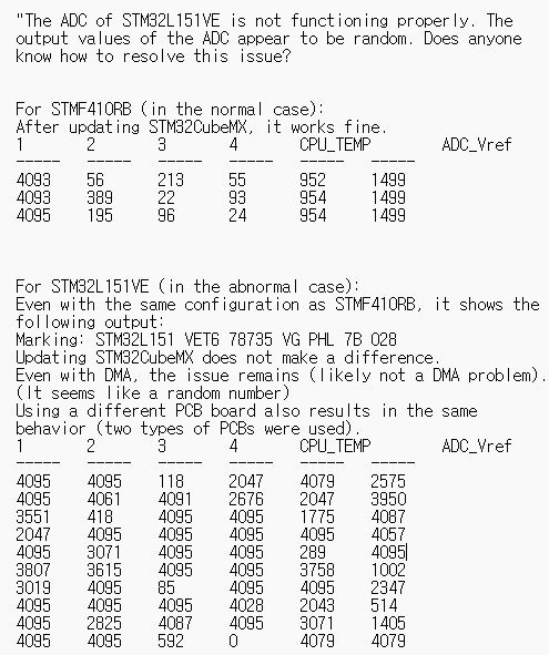

"The ADC of STM32L151VE is not functioning properly. The output values of the ADC appear to be random. Does anyone know how to resolve this issue?

void MX_ADC_Init(void)
/* USER CODE BEGIN ADC_Init 0 */
/* USER CODE END ADC_Init 0 */
ADC_ChannelConfTypeDef sConfig = {0};
/* USER CODE BEGIN ADC_Init 1 */
/* USER CODE END ADC_Init 1 */
/** Configure the global features of the ADC (Clock, Resolution, Data Alignment and number of conversion)
hadc.Instance = ADC1;
hadc.Init.ClockPrescaler = ADC_CLOCK_ASYNC_DIV4;
hadc.Init.Resolution = ADC_RESOLUTION_12B;
hadc.Init.DataAlign = ADC_DATAALIGN_RIGHT;
hadc.Init.ScanConvMode = ADC_SCAN_ENABLE;
hadc.Init.EOCSelection = ADC_EOC_SEQ_CONV;
hadc.Init.LowPowerAutoWait = ADC_AUTOWAIT_DISABLE;
hadc.Init.LowPowerAutoPowerOff = ADC_AUTOPOWEROFF_DISABLE;
hadc.Init.ChannelsBank = ADC_CHANNELS_BANK_A;
hadc.Init.ContinuousConvMode = ENABLE;
hadc.Init.NbrOfConversion = 6;
hadc.Init.DiscontinuousConvMode = DISABLE;
hadc.Init.ExternalTrigConv = ADC_SOFTWARE_START;
hadc.Init.ExternalTrigConvEdge = ADC_EXTERNALTRIGCONVEDGE_NONE;
hadc.Init.DMAContinuousRequests = ENABLE;
if (HAL_ADC_Init(&hadc) != HAL_OK)
Error_Handler();
/** Configure for the selected ADC regular channel its corresponding rank in the sequencer and its sample time.
sConfig.Channel = ADC_CHANNEL_19;
sConfig.Rank = ADC_REGULAR_RANK_1;
sConfig.SamplingTime = ADC_SAMPLETIME_384CYCLES;
if (HAL_ADC_ConfigChannel(&hadc, &sConfig) != HAL_OK)
Error_Handler();
sConfig.Channel = ADC_CHANNEL_20;
sConfig.Rank = ADC_REGULAR_RANK_2;
Error_Handler();
sConfig.Channel = ADC_CHANNEL_21;
sConfig.Rank = ADC_REGULAR_RANK_3;
Error_Handler();
sConfig.Channel = ADC_CHANNEL_23;
sConfig.Rank = ADC_REGULAR_RANK_4;
Error_Handler();
sConfig.Channel = ADC_CHANNEL_TEMPSENSOR;
sConfig.Rank = ADC_REGULAR_RANK_5;
Error_Handler();
sConfig.Channel = ADC_CHANNEL_VREFINT;
sConfig.Rank = ADC_REGULAR_RANK_6;
Error_Handler();
