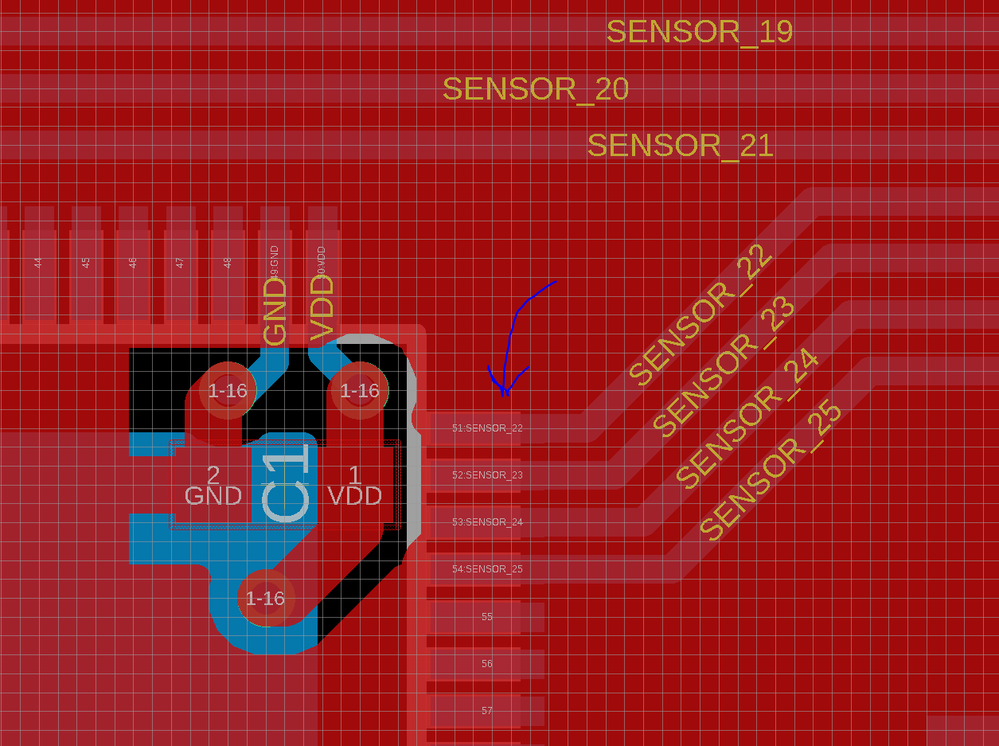

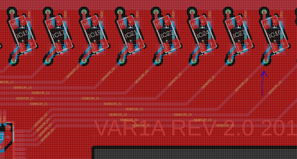

Not sure if I messed something up. Signal is okay (on the pin). No differences with layout compared to other inputs. ADC is at full speed (16 MHz).
On image it is sensor 22 (reads ~2500). Sensor 23, 24, 25 all read normal values (~3000).
Voltages on all those pins is ~2.8V.
VREF, VDDA, VDD = 3.3V.

Your layout does not help to identify what Port Pins you use. How fast is your sampling? Maybe this is some issue with fast versus slow channels when sampling fast.
Exactly, there is a charge-up of the S&H capacitor involved.
Too short sample times create a "drag over" or pseudo-crosstalk effect.

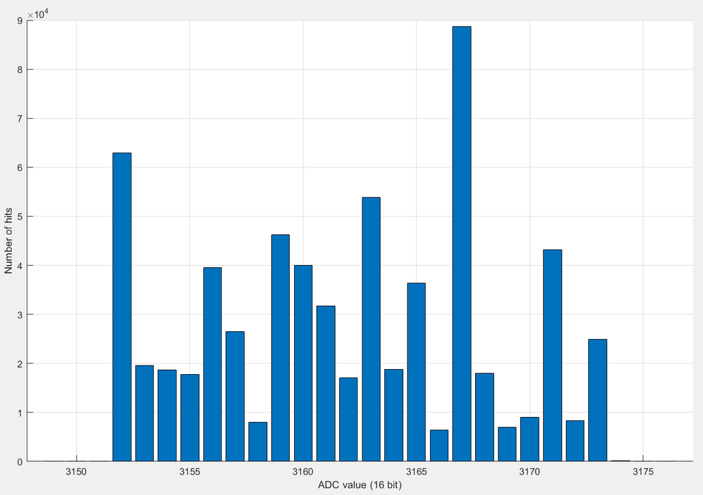

16 MHz (1 mega samples), 4 cycles sampling time.
Only 1 channel out of 24 which are all read in sequence reads lower value (consistently). I moved it around in a sequence but it didn't change anything.
Correction: sampling it multiple times does change the reading.

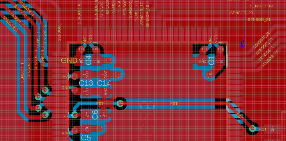

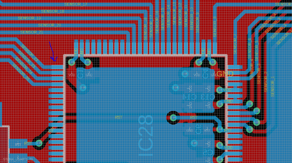

Can we see the top side of the PCB ?
Pavel Krupets
MikeDB
Lead
Actually that's the best connected of the lot. Something the other end of the track maybe ?

Have you examined the PCB with a magnifying glass and checked you don't have a manufacturing fault on that pin ?
Pavel Krupets
I checked signal on oscilloscope and it looks just fine. Both ends. Signal is low frequency, analog.
Not a lot of noise in signal lines.
