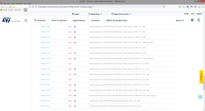

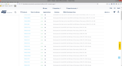

So, I looked at the 'L1, too - the newer ones from them (as witnessed by the -A suffix on some of them) appear to be un-NRND'd too:
and although only the older ones appear to be still NRND'd according to the product list:

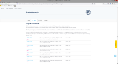

the 10-year commitment list lists all of 'L1 as NRND with the end-date not renewed and to be expired at Jan 2032:

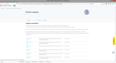

Btw. the STM8 (except automotive) are in the 10-year commitment list listed as Active but with non-renewed expiration at Jan 2032 too:

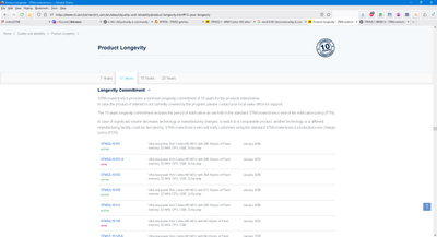

Meantime, some of the 'L1 appear to have been un-NRND'd, too:
