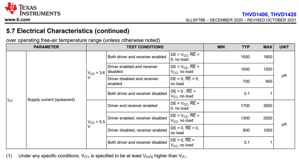

Is the transceiver on in lower power mode? Is it powered? What do you want the DE pin to be at during low power mode?

Have you tried measuring the currents into & around the transceiver?
The THVD1400DR  is a TI part - so have you contacted TI for support/recommendations on how to achieve lowest power with their product?
https://www.ti.com/product/THVD1400#support-training
Are you correctly disabling both receiver & transmitter to achieve minimum consumption:

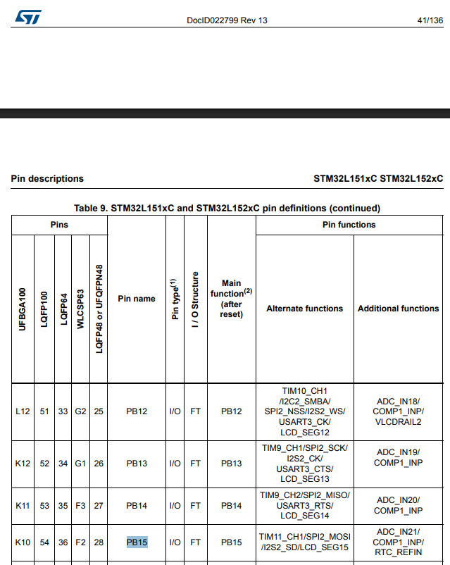

VLe R.1
The transciever is in low power mode, I made many current measurements to know for sure it is doing it. I ended up changing the pin to PA12 for controlling the DE pin and the problem was solved, so it has to be something related to the pin PB15 capabilities as all I did was just changing the pin on cube MX.
Also the connections to the pins of the transciever are just direct connections, the only add on is a pull up resistor on the RS485 data transmit to the MCU when it recieves data from de bus.
@VLe R.1 wrote:
I made many current measurements to know for sure it is doing it. .
Remember that we can't see those measurements, so we need to ask the questions!
@VLe R.1 wrote:
I ended up changing the pin to PA12 for controlling the DE pin and the problem was solved, so it has to be something related to the pin PB15 capabilities .
Indeed, there's a lot more stuff on PB15 than on PA12:
