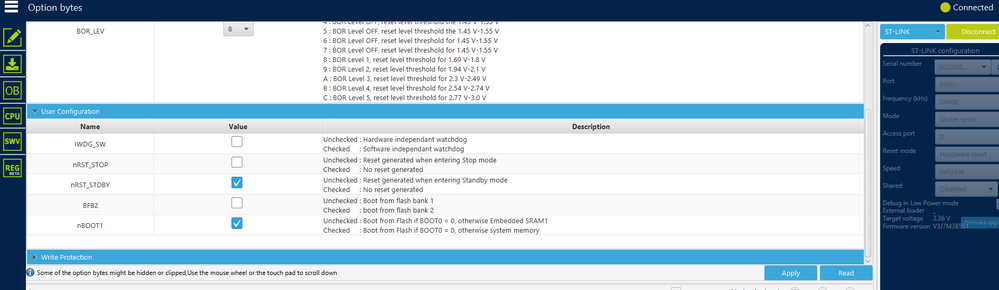

I can see weird behaviour on my STM32L083RBT6. Do not know where to start - I will try:
  • When I run my app with Window WD - everything works fine
  • When I run my app with Window WD disabled - not every start of my app (power on by inserting battery) starts up corectly - it means the app remains stuck in unknown place (in time < 100 ms after power on)
  • When I continue to toogle battery connecting (power on -> power off), so about after 20 cycles the mcu always starts up correctly but after about 500 ms the mcu always resets -> then starts up -> resets and again and again with period about 500 ms - from this moment it looks like the mcu is corrupted - Nothing like reflashing app (with or without WD) can save the mcu. In this state I tried to debug why the mcu resets - by reading the RCC->CSR register - but there is always bunch of set bits (WWDGRSTF, IWDRSTF, PORRSTF, PINRSTF, SFTRSTF) - so this feature probably does not work!
No voltage spikes captured on power pins during connecting and unconnecting battery.
I will be very grateful for any help.
So now It is clear. I had unchecked WDG_SW - it means the IWDG was activated by harware and this is why the reset occured.
What I do not understand is why this bit was unchecked.

when I clear it so PINRSTF and IWDGRSTF are set after reset, But I have disabled RTC, LSI, and IWDG -then how could IWDG cause a reset?
IWDG may be enabled in the option bytes. Check using stm32cubeprogrammer.
When check IWDG - so by stm32CubeProgrammer is disabled. I can say that I do not modify any options byte in my code and I flash it only from STM32Ide by Jlink programmer. I do not really understand this behaviour :(
I also set BOR level to Level1 from code. But now I commented this settings.
BTW by reseting mcu the BOR level is resets to default state or do I need to do full erase of chip?

Current state:
  • Tried to change IDE from STM32CubeIde to Atollic True studio, also I generated a new project from CubeMX to a new workspace - without any progress (on the same computer)
  • Tried to add to my code init and start of IWDG with the biggest divider and reload value - when I do it - the priod of reset is increased to about 5 seconds. When I do not init and do not start IWDG - the period of resseting is back on value about 500 ms.
  • Finally: without initialized IWDG I just tried to refresh IWDG - and it works - app runs without resets.
It looks like the IWDG is activated despite the factI didn't allow it?!?
