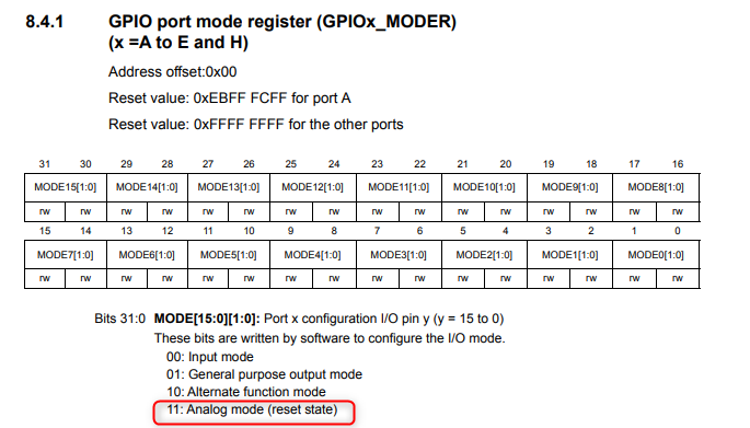

I would like to know, why unconfigured pin is consuming power when it is connected to 3.3 volt, while it is in analog input mode (reset mode as per to the data sheet).
here, what i have tested with three configurations.
with pin configuration(PA8 and PA11) in STM32CubMax
no configuration (Reset mode by itself) - 0.8W (unused pin connected to 3.3)
input mode configuration             -0.5W (unused pin connected to 3.3)
input analog configuration            -0.5W (unused pin connected to 3.3)
so what makes change in no configuration from STM32CubMAx and analog input(GPIO_MODE_ANALOG) and input(GPIO_MODE_INPUT)
what other parameter internally changes by doing

-- input configured      1 10 10 01 00 10 10 00 11 11 11 11 10 10 10 11
-- reset and input analog 1 10 10 01 11 10 10 11 11 11 11 11 10 10 10 11
please share you input, what could be the reason behind change in behavior by making change only in configuration.
if it is already in reset mode then why have to configure in software? and why it makes a change while configuring in software as analog input then reset state by it self(without software config)?

If configuration 1 and 3 are identical as far as the GPIO registers, I don't see how there could be a difference in power consumption.
But they're not at the reset values given in the RM, so perhaps you're doing something else in the code that is causing the discrepancy.
In your "configuration as analog input", PA9 is set to AF mode. So something else is going on.
DRamo.1
yes,1 and 3 identical
But if you do not do software based initialization then it is taking analog (11) automatically.
but why 1 consume more power which is default than software based configuration in 3, is there any hidden configuration?
configuration as analog input and reset (no code initilization in sw) are identical
1(no code ) -- 01 10 10 01 11 10 10 11 11 11 11 11 10 10 10 11
2(input code init) -- 01 10 10 01 00 10 10 00 11 11 11 11 10 10 10 11
3(input analog code init )-- 01 10 10 01 11 10 10 11 11 11 11 11 10 10 10 11
and PA9 and PA10 is used as an uart but that are same to all configs. I don't think it has any impact.
