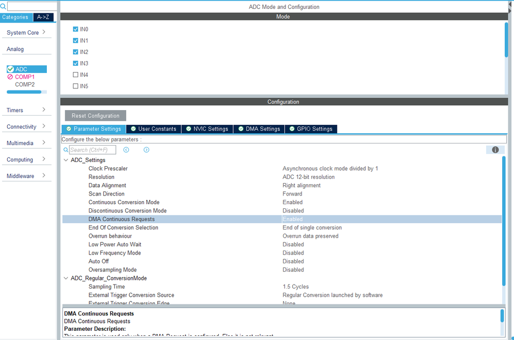

Hey. I am trying to read multiple ADC channels using DMA but with no luck. My project settings:
I have selected 4 channels and enabled Continuous conversion mode as well as DMA Continuous requests.

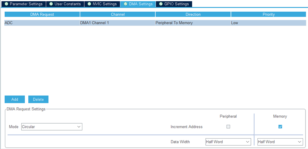

I have also created a circular DMA for ADC :

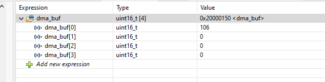

As you can see I have created an array of size 4 for my DMA buffer:
uint16_t dma_buf[4];
and I start the DMA:
HAL_ADC_Start_DMA(&hadc, dma_buf, 4);
I set a breakpoint in while loop every 1 second and have added dma_buf to the expressions. Only the first element of an array is getting filled and it seems that it is a wrong value. I have about 2.9V on that pin so a reading should be about 3600 or 3500:
4 REPLIES 4

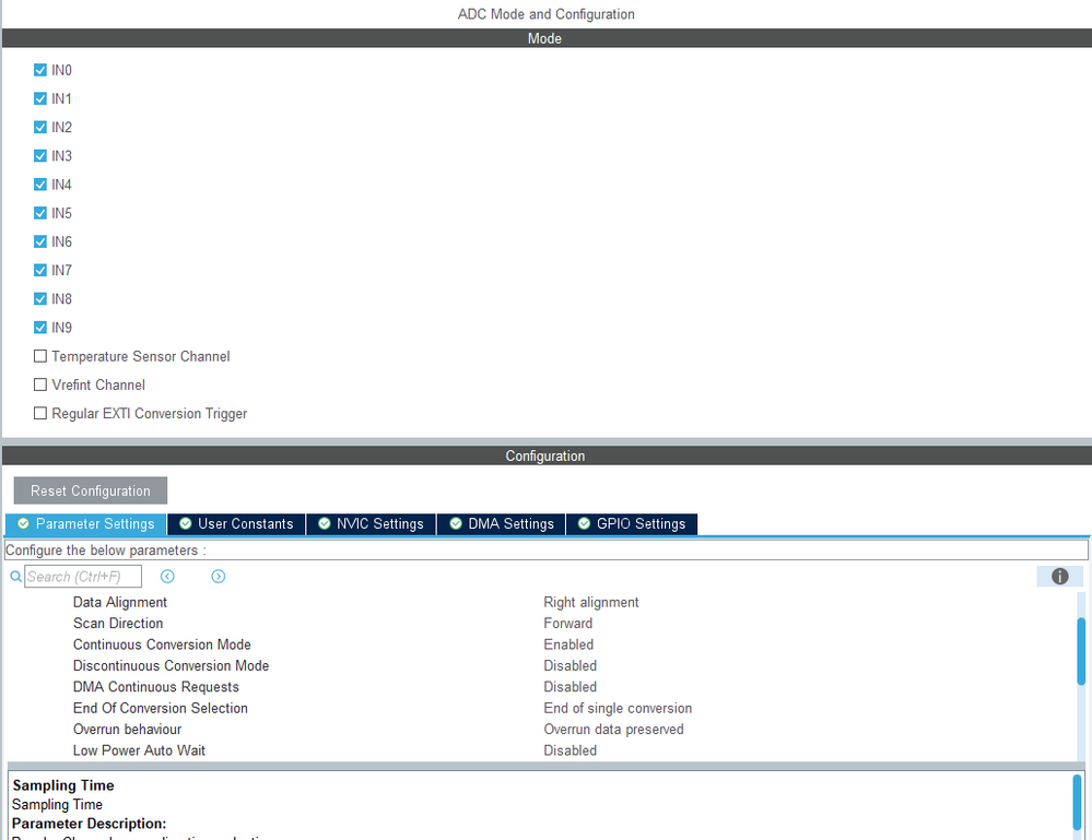

I have also attempted to try and read multiple channels using polling method instead of DMA.

and etc.... As you can see, it is messed up. Could someone help me understand why would that happen?
well spotted. That was indeed an issue with the CubeMX generating code in wrong order. What a silly mistake form CubeMX side. Thanks

With 1,5 sampling cycles the total conversion time is 14 cycles. Those are ADC clock cycles, but it's still pretty fast. The code of the HAL broken bloatware just cannot keep up to such speeds, especially when compiled in debug mode with no optimizations. And, even with a decent optimal code, which disables interrupts, capturing multiple ADC channels without DMA is not a good design.
