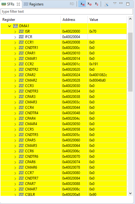

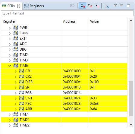

JAN R
Posted on October 11, 2017 at 16:40
You can see the content of registers bellow:
Thank you, Jan.
waclawek.jan
Posted on October 11, 2017 at 17:06
Both DMA_CNDTR2=0 and  DMA_ISR=0x07 indicate that the DMA has already run into completion.
Posted on October 11, 2017 at 16:01
Dunno. Post the content of relevant DMA and TIM registers.
