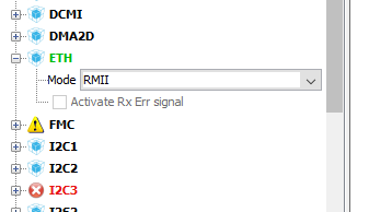

I am using the latest ST32CubeMx Ver. 4.22.
Creating a new project with the wizard and selecting my target board Nucelo STM32F429ZI.
When selecting the middleware ETH connectivity I have DP8348 as only choice where the board is with PHY from Microchip 8742A. Since the board is not really new I thought this should be known already..
I can see that something with ETH init is to read over the DMA that the PHY has gone through reset which means sending other info then 0x0 I guess

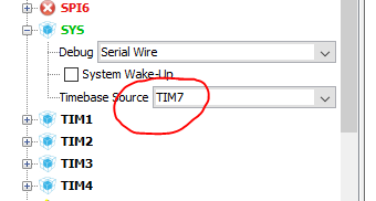

1. SysTick_Handler call osSystickHandler, but none of them increments
the tick counter. Don't why, I added this at the begining of the
osSysTickHanlder
osSystickHandler
    HAL_IncTick();
2. TICK_INT_PRIORITY made the highest since I am calling for HAL_delays
in different tasks.

3. Last... and most important are the corrected settings for the PHY8742A
https://github.com/ronen-yacobi/LwIp_TcpUdp_EchoServer.git
Posted on October 11, 2017 at 18:32
Hello!
Try to use R.MII mode.
And for the systick , you must avoid to use Systick timer  for HAL when you use also a RTOS.
Use another timer  to avoid theese problems.
The generated code will include HAL_IncTick(); in Timers IRQ handler.
