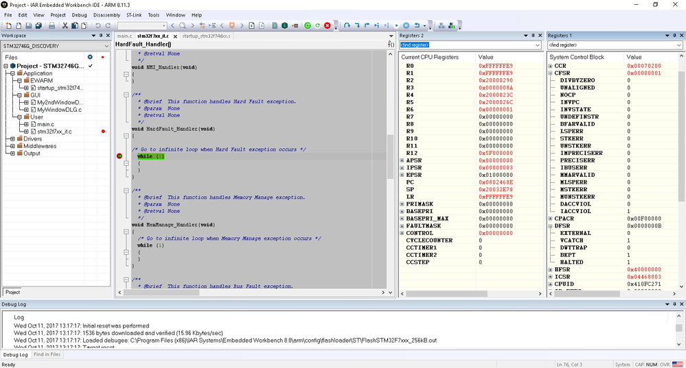

I have created a simple project based on the “STemWin_HelloWorld� example for the STM32746G Discovery Board. I have created two screens with a button on each. The button on each screen loads the other screen, and visa-versa. If you switch back and forth the screens a couple of times the program gets stuck in the “void HardFault_Handler(void)� routine.
From the viewing, the System Control Block Registers with the debugger I can see that the following bits are set.
BusFault Status register
BFSR -> BFARVALID
BFSR -> IMPRECISERR
UsageFault Status register
UFSR -> UNALIGNED
UFSR -> UNDEFINSTR
Different combinations of these bits are set each time you reset the MCU. From reading the manual it appears that a bad instruction is causing the fault but I am unable to narrow down as to where. Can anyone please assist in stopping the program going into the “void HardFault_Handler(void)� routine?

Try using a reasonable Hard Fault Handler and review the faulting instructions and registers. Disassembly view.
Is the stack sufficiently large? Are you corrupting structures on the stack? Review your use of local/auto variables.
If it tries to execute 32-bit ARM code it will fault.

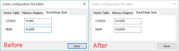

How do I increase the stack size? Is there a header file with a ♯ define to change?
I can already see the register values from my debugger. But how do I interpret this?

To change the stack size in IAR IDE:
Project->Options->Linker->Config Tab and Edit Linker configuration file.

Hi ra hummel.
Thank you for your comment. I made the below changes and I no longer get this fault. I will have to consult the IAR manual to better understand the CSTACK and HEAP.
How do you determine what sizes these should be?

The stack size depends on your application and the libraries you are using, see

Tools like Keil can get an estimation of call tree depth and stack usage from a static perspective. You can walk the trees yourself and sum up the local/auto arrays/variables you are allocating, and come up with a reasonable guess. From an active/dynamic sense you can paint the stack with a recognizable character/string and figure the maximal depth viewing the memory from the debugger.
From a Hard Fault debugger view you'd want to look at the appropriate stack as well as the registers, the registers of most interest being pushed on the stack, hence the 'blue screen' type trap message I've shown which can be used on systems not under active debugging. This can be useful for field debugging, as you'll learn zero from a system in a while(1) loop on the phone or via email.
