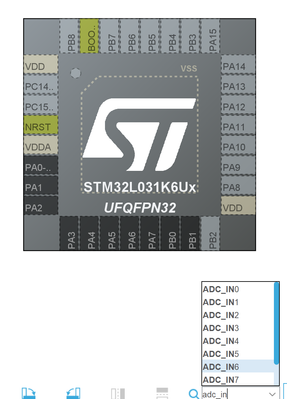

Hello ST Support Team,
I'm working with the STM32L031K6U6 (32-pin UFQFPN package) and need clarification on ADC channel mapping.
Question: Is there an ADC Channel 9 available on the STM32L031K6U6, and if so, which physical pin does it map to?
Context:
- I'm trying to use PB1 as an ADC input
- Documentation suggests ADC Channel 9 should be available
Could you please confirm:
1. Which pins have ADC capability on STM32L031K6U6 32-pin package?
2. Is ADC Channel 9 available on this specific package variant?
3. If ADC Channel 9 exists, which physical pin does it connect to?
Hardware: STM32L031K6U6 (32-pin UFQFPN package)
IDE: STM32CubeIDE
HAL Version: Latest
Thank you for your assistance.

hello @vardhaman_k
and welcome to ST community!
Based on the product Datasheet, Table 15, the ADC channel 9 pin is available on PB1.
Hope that helps
Gyessine
CubeMX can highlight pins for you. This information is also available in the datasheet.
Here are the 10 pins with ADC capability on this chip:
