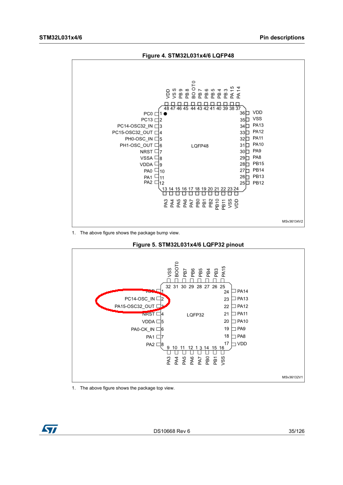

STM32L031 LQFP32 pinout is wrong
waclawek.jan
0693W000008G98mQAC.pngBoth pins 2 and 3 are incorrectly described:
  • pin 2 is PC14-OSC32_IN
  • pin 3 is PC15-OSC32_OUT
Maybe other 'L0xx DS are affected, too; I did not check.

​Hello @Community member​,
Thanks Jan for helping us to improve the ST documentation.
I will check.
