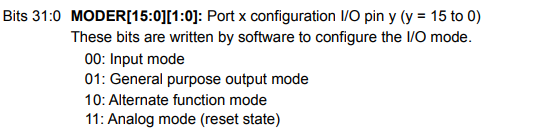

Hello @Jacob L​ ,
it is possible that the PB8 pin is configured as an alternate function other than GPIO, to check that, try reading the GPIOx_MODER register :

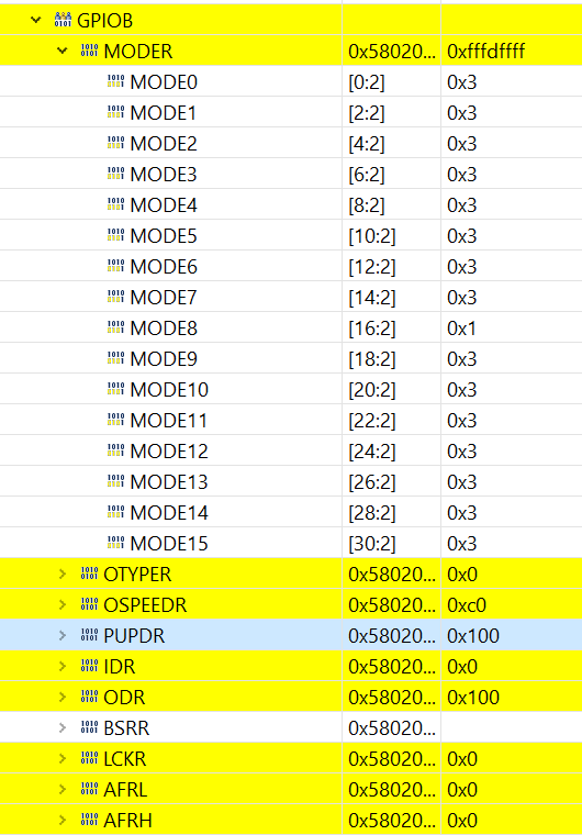

That seems to be set correctly. Any other suggestions? Does ST have a test board with an STM32H7B3NIH chip you could try?

Yeah good idea. I am just single stepping though so I would see it go high if it worked...
