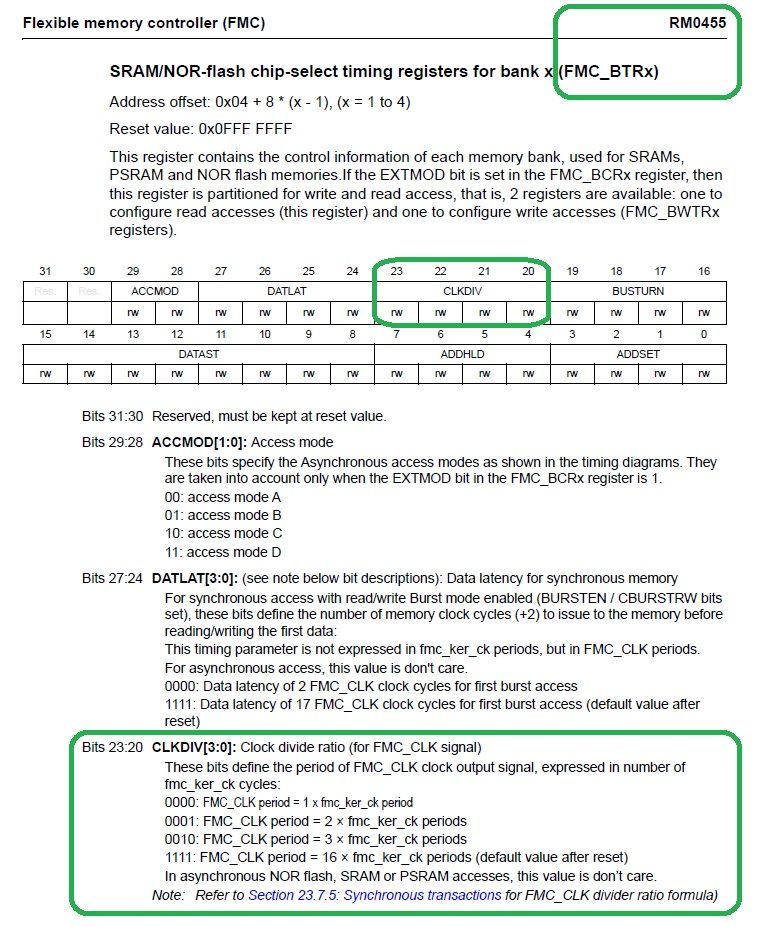

On the H7 the FMC clock should be configurable as HCLK/2 or HCLK/3, it should be a specific setting, unrelated to RAS/CAS
Mainly as the Pin's IO Drivers (transistor level) are rated much above 100 MHz
FMC_BTRx CLKDIV (x = BANK)

> The problem is that I cannot find all the configuration parameters in the IOC.
Then simply don't use Cube/CubeMX. You surely want control which is rarely achieved by clicking. Start from the FLASH DS and the FMC chapter in RM, calculate your parameters, set up the couple of FMC registers needed, and verify by measuring.
