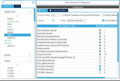

sqwerize
Hi, did u fix it? I have STM32H750XBHX with same problem...
I also have a callback for CAN1 but it is not called at all. I have an interrupt set up in NVIC....
I checked via FreeRTOS if receiving works and here surprise, receiving and sending frames from task level works very well....

void HAL_FDCAN_RxFifo0MsgPendingCallback(FDCAN_HandleTypeDef *hfdcan)
LED1_ON();
if(hfdcan->Instance == FDCAN1)
FDCAN_RxHeaderTypeDef RxHeader;
uint8_t RxData[8];
// Pobierz ramkę
if(HAL_FDCAN_GetRxMessage(hfdcan, FDCAN_RX_FIFO0, &RxHeader, RxData) == HAL_OK)
