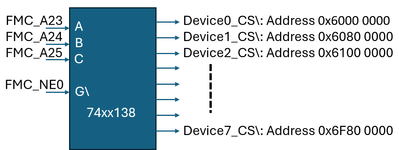

To expend NE/Chip select better to use 3 to 8 line decoder like the 74xx138 or equivalent.
A, B and C inputs of that decoder are connected to the highest lines address of the FMC. So one SRAM bank will be divided to 8 regions equal of size of 8MByte.
G input of the 74xx138 will be connected to one of the NE of the FMC pins.
Example with FMC_NE0 and the different devices address (maximum 8 devices per FMC_NEx):
Hope that helps.
Hope that helps.

You asked already the same questions.
You cannot use FMC_D0-D7 to enable chip select. FMC_D0-D7 are for data and CS pins is intended to be driven by FMC_NEx.
You can use a simple GPIOs but you need to ensure the correct Set/Reset at the right times and avoid conflict between the devices. And frankly I don't know for the LCD, I'm not sure, it could be not.
That's why I'm suggesting to use an external decoder for your application. That solution avoids any conflict and any CS set/reset timing issue .
Hope it's clear now.
