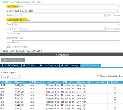

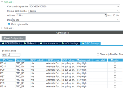

To make it clear we have the following prototype
1.  LTDC+SDRAM for the RGB Display (800x480) where FMC configures SDRAM and provides sync and access to LTDC , Works fine (Where SDRAM uses FMC_A0 to FMC_A11 and FMC_D0 to FMC_D15)
2. On top of Point.1, additionally configure FMC as LCD_Interface(8080 Parallel) but just to read Parallel data from another controller. (Which uses FMC_D0 to FMC_D7 and FMC_A0, same data and 1 address lines as above)
