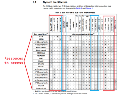

Are there any signals that cannot be used with M4 and M7?
For example, only M4 can connect to Ether, and only M7 can use SDIO.
The answer is given in the RM0399 / Table 2. Bus-master-to-bus-slave interconnect
ETH and SDMMC are masters like Cortex-M7 and Cortex-M4 and you can use ETH and SDMMC either on Cortex-M7 or Cortex-M4 but you need to ensure that the shared memory between ETH/SDMMC is accessible by the Cortex-M. For that you need to check that in the table above.
