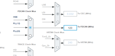

Hey, I have a problem with the callback for FDCAN1. I am sending frames through ucandevices converter but the callback for FIFO0 is not called. The frames are definitely arriving, I added a test FreeRTOS and a task to receive and send frames to CAN1 and it worked very well, frames were received and sent back to the bus.
I have NVIC interrupts set up, I fiddled with the clock for CANFD and speeds, also with no effect.
Is anyone able to help me?

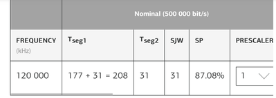

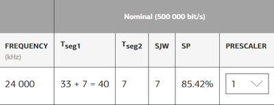

If i remember your clock was 24MHz so these are the settings for 500/kbs

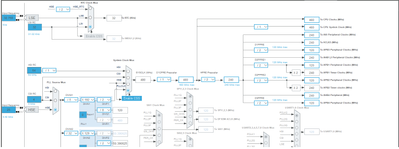

I changed the clock but I don't know if I did it right.... And should the Clock for FDCAN be set to HSE?

THANK YOU VERY MUCH !! By the way, can you tell me what this tool is?
