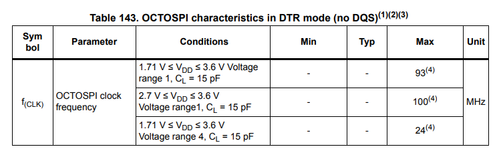

Could you please share clock and data waveforms for different frequencies: 50 MHz and 80 MHz?
Which voltage range are you using?
Please refer to STM32U585 datasheet and check the maximum OCTOSPI clock?

I suggest you refer to the datasheet, and find the "power configuration" of your board to see the maximum frequency the STM32U585 can run.
if you are developping a new board, the next point maybe to check there's no hardware constrain for the layout of the board, Impedance matching, equal length...

We try to find the problem, and our solution was the same with Your recommendation.
We using the APS51208N, and it working fine.
I think the problem was with the tracing, because we can't reach higher speed than 50MHz.
