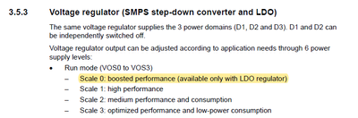

mƎALLEm
Hello @KimJaeJoon ,
That's normal. You're using SMPS in boosted performance (VOS0) which is not allowed in the spec.
In SMPS configuration, the maximum frequency you can reach is 400MHz @VOS1. Only LDO can be used with VOS0.
This is already mentioned in the datasheet:
Also as said by @STOne-32 22uF is not the right value recommended for VCAP pins.

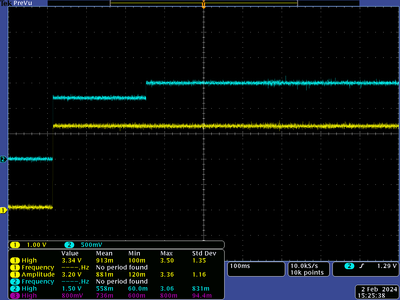

Thank you for answering my Problem.
I would appreciate it if you could refer to the picture above.
above picture is direct SMPS supply mode schmethics.

room temperature is well powering On & powering Off.
Conneting ST-Link V2/V3 is very well too.
but below -10°C Temperature, sometimes doesn't powering On.
plus, i can't connet ST-link V2/V3 too.
umm.. and Vcore Voltage is 1.5V.
Reference manual & User Manual explained direct SMPS supply mode is can set up to VOS1.
and Vcore Voltage max value is 1.26V.
current My Setting is below :
1. direct smps supply mode
2. v scale 0
3. wait for vosrdy flag
4. and application start
and then, My situation right now is 0.24V over.
Could this also cause the problem?
