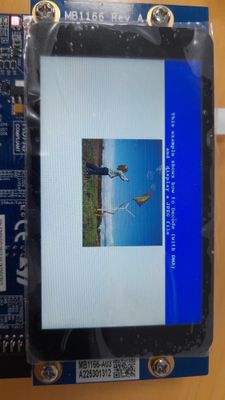

Hello @JL3 and welcome to the Community :),
Please make sure that the display is correctly connected to the board. For that please unplug and plug the display.
I tested JPEG_DecodingFromFLASH_DMA example located in STM32CubeH7 1.11.2 version with STM32H747I-DISCO board D03 and MB1166 A-03 and using STM32CubeIDE1.15.0 version and it works properly.
To check the issue could you please precise:
- Which STM32H747I-DISCO revision are you using? MB1248-H747I-D02, MB1248-H747I-D03 ...?
- Which LCD revision are you using? MB1166 A-02, A03, A09.....?
Thank you.
