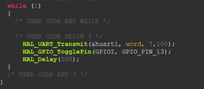

And corrected the Pins to PA9 and PA10 in msp.c file and verified the code several times, but still no text/data was displayed in Putty and Tera Term. I also tweaked the settings like baud rate (applied the same baud rate in tera term) and tried keeping pull mode to GPIO_NOPULL and also in GPIO_PULLUP modes but still there is no output on tera term and putty. In my code in Cortex M7 main.c file, there is a toggle LED function and it works perfectly.

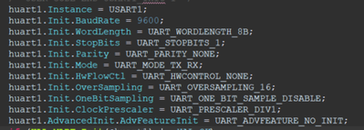

Below image shows my UART Initialization in main.c

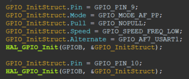

Below image shows the UART initialization in msp.c

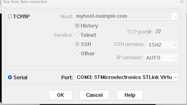

Below image shows the settings i made in Tera Term

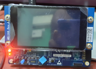

Below is the image of by board when executing the code.

The pins are on GPIOA not GPIOB

SKuma.49
It Works!!!
Thank you, Tesla DeLorean,
I changed the port to GPIOA in all places related to UART as per your above code and now I am able to receive the data in putty.
