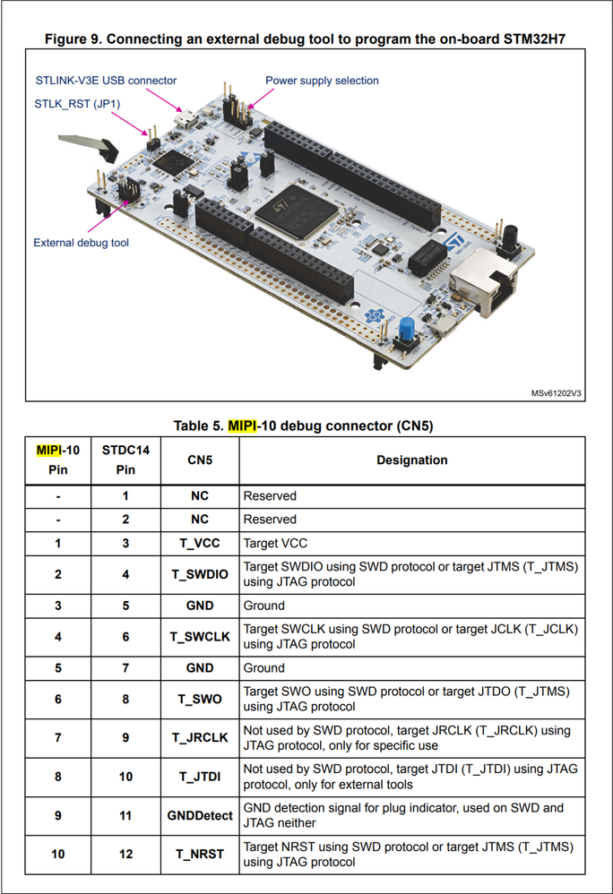

Do you reference to a NUCLEO-H7 board (e.g. the NUCLEO-H743ZI2)?
I did a measurement: pin 1: it is 3V3 (and it has to be T_VCC as such 3V3 or 3V1).
But:
See in schematics that pin 1 is not pin 1: the MIPI connector is soldered with an offset and "real" pin 1 is not connected.
Show us your schematics.
Have you tried with a patch wire to bring target VDD to pin 1?
