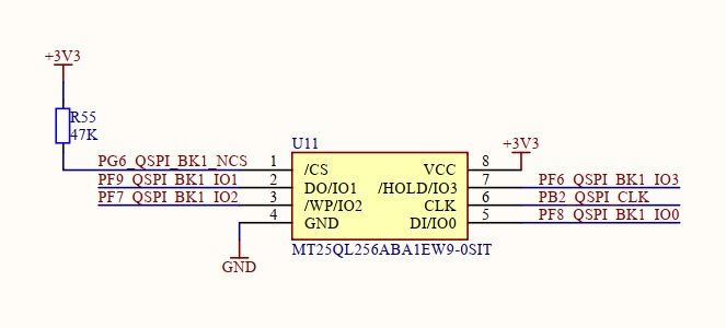

I designed custom board for stm32h745xit6 .
My TouchGFX working fine with internal flash .
_legacyfs_online_stmicro_images_0693W00000dDVHoQAO.pngThe core board has mt25ql256a and connected as under
PB2 CLK
PG6 NCS
PF8 D0
PF9 D1
PF7 D2
PF6 D3
I generated STLDR as explained in ST videos tutorial.
my generated STLDR file is visible and selected as external loader , but it gives error when programming 0x90000000 ...
kindly help me
thanks in advance.
IN
You've also contacted me privately. If the ones I've built aren't functioning, I'll need to work on them some more. Not sure how much time / resources I can commit to that immediately.
What you can do, is write your own BSP and prove that the QSPI implementation that you have is viable. That you can read, write, and erase from application space, in a manner that you can debug and instrument to validate design level functionality.

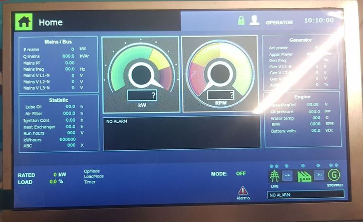

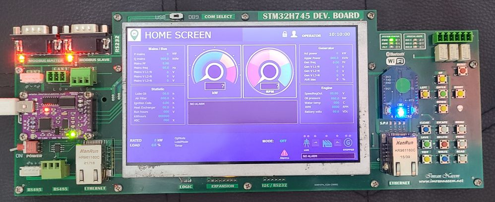

Here is my custom designed board with STM32H745XIT6 & 1024X600 RGB TFT with TouchGFX.
CM4 running Modbus Master RTU
CM7 running TouchGFX with 256MB SDRAM
Here is TouchGFX , running on SAMSUNG TAB3 7.0 ,, 1024x600 , LVDS LCD (STM32F429i-DISCOVERY + SN75LVDS83B) :

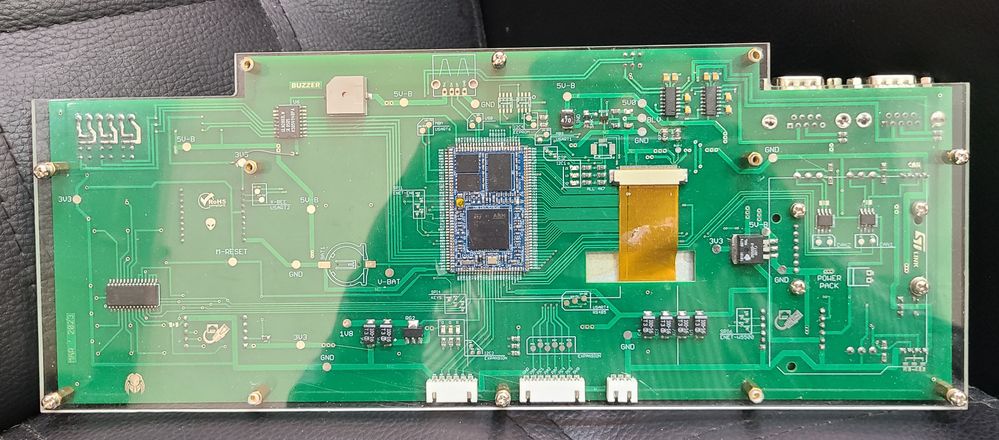

Here is my new version custom designed board with STM32H745XIT6 with add-on cards for different types of lcds like LVDS , RGB , HDMI , DVI , VGA .
Presently RGB TO LVDS card is fixed on left side with SN75LVDS83B (RGB to LVDS Bridge chip)20230811_104031.jpg20230811_104211.jpg
Here is TouchGFX , running on SAMSUNG TAB3 10.1 inch ,, 1280x800 , LVDS LCD (STM32H745XIT6 + SN75LVDS83B)
Its running on same above board which I developed 3 weeks ago ..
