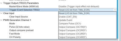

I have timer 1 setup to PWM a wave form and timer 2 setup to PWM a different frequency wave form. I need to restart timer 2 when an output compare match (CNT = CCR) on timer 1 occurs. It appears that I can do this with master/slave configuration of the two timers but I am struggling with the reference manual explanation. If I want to use timer 1 as the timer master and timer 2 as the timer slave, is it only timer 1 channel 1 (OC1) that I can use as the timer master? It looks like the reference guide, table 351 is telling me that when TIM2 is the slave and TIM1 is the master that I will need to be configuring for ITR0, but there is limited definition there for what the table means. Any confirmation or tripping points would be appreciated, if there is a good app note that covers this, that would be appreciated a point to also.

Each timer has a single TRGO signal which can be hooked up to a bunch of things internally. You want this hooked up to OC1 or OC1REF on the master timer if you're using channel 1 as your PWM.
On the slave timer, set it up so that the timer resets when the TRGO signal occurs. Slave mode: Reset mode. and set the trigger source to the correct value. Probably ITR0 for a TIM1 master.

- set TIM1_CR2.MMS=0b100 to select OC1REF (i.e. output from the TIM1_CH1 comparator) as TRGO (trigger signal going out from timer), or 0b101..0b111 for OC2REF..OC4REF

Thanks both of you, I reviewed both your your responses. I was trying to use timer 1 channel 3 to synchronize timers, I moved to timer 1 channel 1. My timers synchronize like needed when I setup TIM1_CR2 MMS bits to 011 (compare pulse) as long as I'm using channel 1. So my problem is resolved.

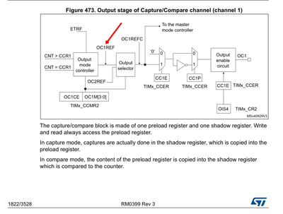

I think my biggest barrier was exactly what OC1REF (or OC3REF) is and how it is controlled. When I set my MMS bits to 100 (OC1REF), and have my SMCR setup for ITR0, it looks like my timer 2 resets exactly when timer 1 resets, and adjusting the channel 1 CCR (pulse length), or changing the pwm output polarity or idle state have no effect on when timer 2 resets, its always immediately after timer 1 resets. Maybe that cookbook document explains OC1REF, I'll look that up. Again, thanks, and my two timers master/slave are now doing exactly what I need.
‎2024-10-02 9:21 AM
Polarity and exact waveform of OCxRef depend on the mode selected in TIMx_CCMRx.OCxM (I've just noticed that in that picture, the incorrect register is mentioned, as OC1CE/OC1M are in TIMx_CCMR1 rather than TIMx_CCMR2). I need to review how do I use it in my programs, maybe I've never though about a combination you are using, PWM1 and PWM2 probably make a difference.
