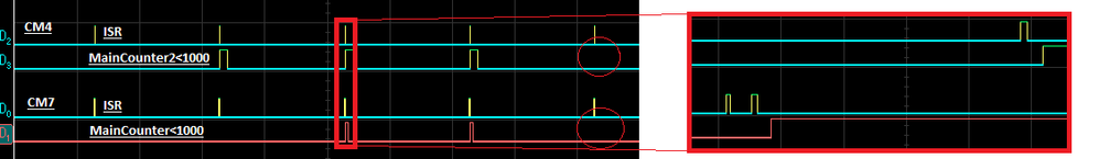

I have a strange problem. I have a global uint32_t variable that counts up in the main loop and every 100 ms it gets reset in a timer-ISR. This works, but sometimes it does not.
Here is the value of the variable MainCounter read out by the debugger:
The ISR is definitely called every time as the toggling variable test shows. Also inside the ISR MainCounter really is zero, I checked. But sometimes this zero does not "reach" the main loop.
Please help, I have absolutely no idea how this is even possible.

Result with IOs, because debugger might (and does) interfere.
So the ISR is called everytime, but MainCounter is not reset everytime. The behaviour is different with or without debugger connected, and also changes with different optimizations levels.

Likely because operation "MainCounter++" is not atomic. It consists of two instructions, the interrupt can hit between them.
This was my first thought, but my second thought was: this is a problem of the (8-bit microcontroller) past.
So if this is an actual problem, I’m a bit disappointed right now and it looks like I have to rethink a lot of code.
Don't rethink, just use the proper thing: atomics.
