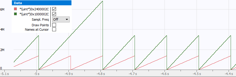

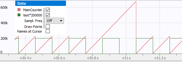

I have a strange problem. I have a global uint32_t variable that counts up in the main loop and every 100 ms it gets reset in a timer-ISR. This works, but sometimes it does not.
Here is the value of the variable MainCounter read out by the debugger:
The ISR is definitely called every time as the toggling variable test shows. Also inside the ISR MainCounter really is zero, I checked. But sometimes this zero does not "reach" the main loop.

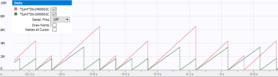

No watchdog. It also happens on both cores.
both cores doing it (-O0)
now compiled with -Ofast for both cores, CM7 looks better*
