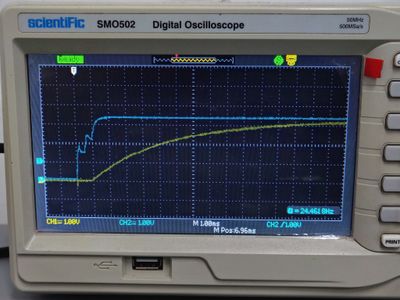

‎2024-07-29 4:54 AM
Boot0 is kept GND through 10K.
Now we have done the task as mentioned below,
- Erase the programmed from the flash memory and check the current, it is 80mA.
- Check the 3.3V and RST signal rise time as per my understanding, it is OK. (Image attached).
- Programmed the STM32H745 in which we have use one GPIO and toggle is at every second and the LED is connected with this GPIO.
- At power ON,
- sometime the LED will toggle. (it takes current around 120mA).
- sometime the LED will not glow. After press the reset switch multiple time it will glow. (When not glow LED, it takes 110mA current).
- We have taken the reading with external 24MHz and internal 32.768KHz frequency.
- We have removed the SDRAM and other hardware from the Board and only keep the MCU and power supply components.
- This is the board which is working up to 1month and we have changed the SD card on this board during power ON condition and after than the issue is coming on this board.
- So, is this chip is partially damaged itself that's why it behaves like this?
Please provide the suggestion on it.
Regards,
Alpesh
‎2024-07-29 6:23 AM
So everything seems ok, when CPU runs and LEDs blinking.
But same CPU can be starting -- wrong.
Just this is a last test: there is the core supply with the 2 uF caps, Vcap. Try just soldering a 470 ohm SMD resistor on one cap, in parallel ( on top, is easy).
Then check starting behaviour again, with the simple test program.
Btw. I found, on some CPU the core voltage not going down fully, then the core gets no correct reset on external reset and behaves silly.
The additional resistor discharge the core voltage and helping the core correctly resets.
So you should check startup after short or longer time without power - might show different behaviour.
If this not giving good behaviour, replace the CPU.
