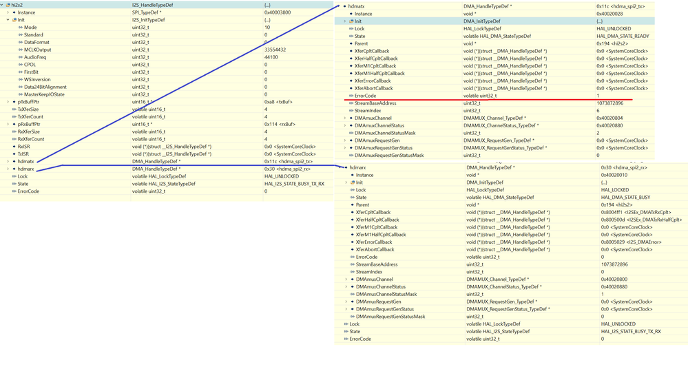

Behaviour in Hardware (via logic analyser)
While in blocking mode all (I2S) clocks are running and transmission is working, in full duplex mode with DMA the signals LRCK, SCLK and Din are dead, on the MCLK pin there is a 5.3 MHz clock signal from the STM32.
Behaviour in Software (via debug)
-         No Error, Full or Half callback will be executed, the main loop is working.
-         I2S2-Typedef says HAL_Unlocked, HAL_I2S_STATE_BUSY_TX_RX, Errorcode = 0
-         Hdmarx says HAL_locked, HAL_DMA_STATE_BUSY, Errorcode = 0
-         Hdmatx says HAL_Unlocked, HAL_DMA_STATE_READY, Errorcode = 1 (DMA transmit error)

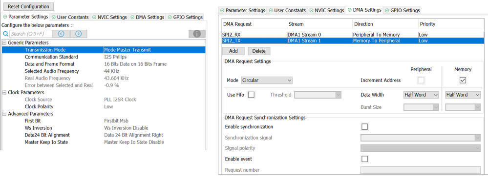

What have I tried so far?
-         I tried to change the linker script (place all in D1 domain) like described here https://community.st.com/s/article/FAQ-DMA-is-not-working-on-STM32H7-devices
-         I tried to reorder the prewritten init functions like described here https://community.st.com/s/question/0D50X0000BsRQmQSQW/stm32h7-i2s-dma-using-hal-firmware-15-troubleshoot
-         I tried to freestyle SRAM enabling (doesn’t look too safe for me) like described here https://electronics.stackexchange.com/questions/389830/tim2-dma-configuration-for-stm32h7
-         I tried to enable the DMA clock by myself (__HAL_RCC_DMA1_CLK_ENABLE()) like described here https://www.youtube.com/watch?v=ToRk2lOhydo
-         I changed the I2S mode to I2S_MODE_MASTER_FULLDUPLEX in init (cubemx bug).

  hi2s2.Instance = SPI2;
  hi2s2.Init.Mode = I2S_MODE_MASTER_TX;
  hi2s2.Init.Standard = I2S_STANDARD_PHILIPS;
  hi2s2.Init.DataFormat = I2S_DATAFORMAT_16B;
  hi2s2.Init.MCLKOutput = I2S_MCLKOUTPUT_ENABLE;
  hi2s2.Init.AudioFreq = I2S_AUDIOFREQ_44K;
  hi2s2.Init.CPOL = I2S_CPOL_LOW;
  hi2s2.Init.FirstBit = I2S_FIRSTBIT_MSB;
  hi2s2.Init.WSInversion = I2S_WS_INVERSION_DISABLE;
  hi2s2.Init.Data24BitAlignment = I2S_DATA_24BIT_ALIGNMENT_RIGHT;
  hi2s2.Init.MasterKeepIOState = I2S_MASTER_KEEP_IO_STATE_DISABLE;
  if (HAL_I2S_Init(&hi2s2) != HAL_OK)
    Error_Handler();
  /* USER CODE BEGIN I2S2_Init 2 */
  hi2s2.Init.Mode = I2S_MODE_MASTER_FULLDUPLEX;
  /* USER CODE END I2S2_Init 2 */

Hey, did you ever find a fix for this? Currently going through this as well

https://community.st.com/s/article/FAQ-DMA-is-not-working-on-STM32H7-devices check this link. It may help you to find out the solutions.
