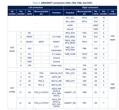

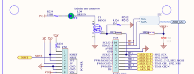

My board schematic :
My board pin definition :

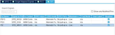

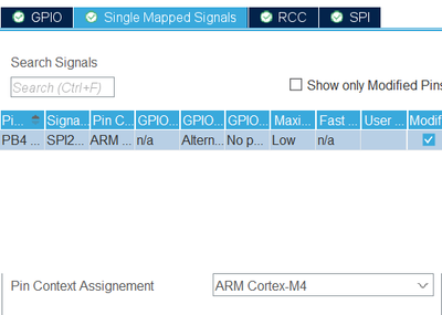

And my board .ioc initialization :
for CS:
for the rest on my pins :

‎2024-06-25 6:37 PM
Since you have selected NSS as software controlled, change the issue to appropriate level, do spi transaction, then de assert
