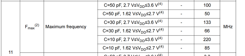

AScha.3
ON h743 port can up to 220MHz , at 11 power setting:
