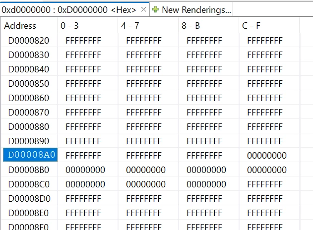

I wrote a test that uses the DMA2D to transfer 64kB of data from AXI SRAM to an external SDRAM.  I set the source data to be all 0xFF and started the DMA.  Using the Memory viewer in STM32CubeIDE I see that the SDRAM is getting filled, but there are random gaps filled with 0.  There is no pattern to the gap spacing.  Example gap shown here.  The zeros were written because there were F's at those addresses previously.

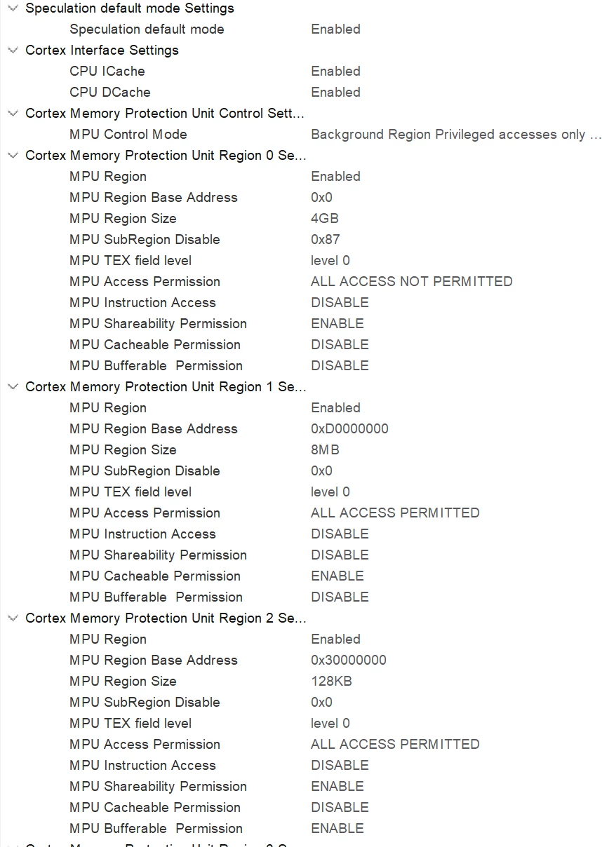

The MPU is enabled and set as follows:
I set AXI_TARG7_FN_MOD.READ_ISS_OVERRIDE to 1 according to STM32H742x/743xI/G, STM32H750xB and STM32H753xI device errata section 2.29.

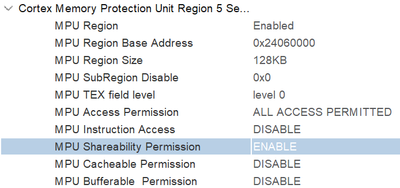

As an experiment, I added a section of AXI SRAM to the MPU config, set it to full access and placed my source buffer at that address.  The transfer happened correctly.  There were no gaps.

Please try to compare/checksum the data in your code instead of viewing in IDE. What you see can be artifact of the debugger (interference with DMA, caching...)

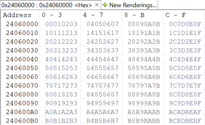

Consider populating memory with more interesting/traceable data. Such as 0x0001 0x0002 0x0003, ... . Then, if it still gets mixed up, you have more of an idea where and how it happened. And if gaps occur, you can determine if bytes were dropped, skipped, inserted, or corrupted.

When I create a section of the AXI SRAM that has ALL ACCESS in the MPU config and place the src buffer at that address, the fails go away.
I'm trying to understand why this works.

Hi TDK,
Thanks for responding.  I tried the data pattern you suggested and I see that the data gets transferred correctly until a 0 gets written in place of the expected value.  See my answer to Pavel above for a snippet from a fail log.
