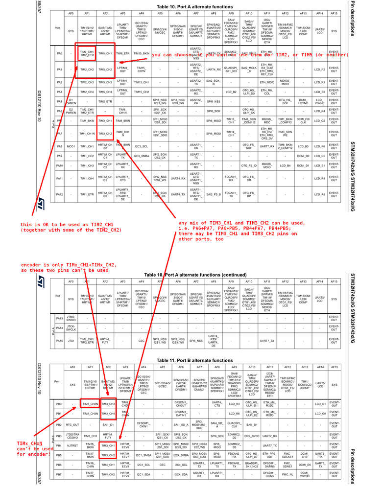

If I may ask about the physical pins on the micro (that carry the signals that then make their way through the internal circuitry before reaching TI1FP1/2) … is it true that any I/O pins can be chosen with this Timer encoder mode, or does this datasheet specifically state which pins can be used ?  I’ve looked but it’s not obvious that they’re limiting the choice hence I’m thinking any pins can be used ?

Only TIMx_CH1/TIMx_CH2 pins.
