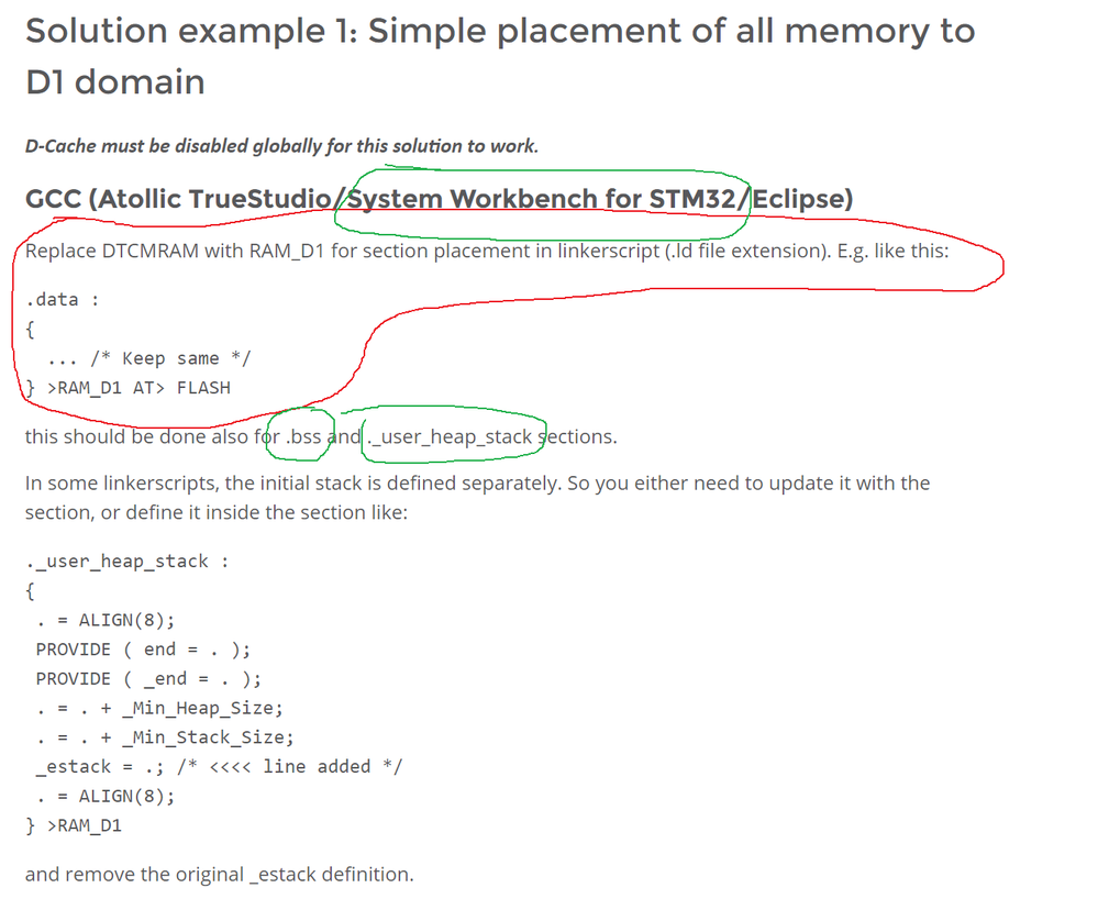

In order to overcome the DMA issue, I select solution 1 which is considered to be the simple method.
0693W00000D03myQAB.pngFrom here there are some confusing things
In cased System Workbench for STM32 - STM32 IDE
quote "Replace DTCMRAM with RAM_D1 for section placement in linkerscript (.ld file extension). E.g. like this:
.data :
  ... /* Keep same */
} >RAM_D1 AT> FLASH
this should be done also for .bss and ._user_heap_stack sections."

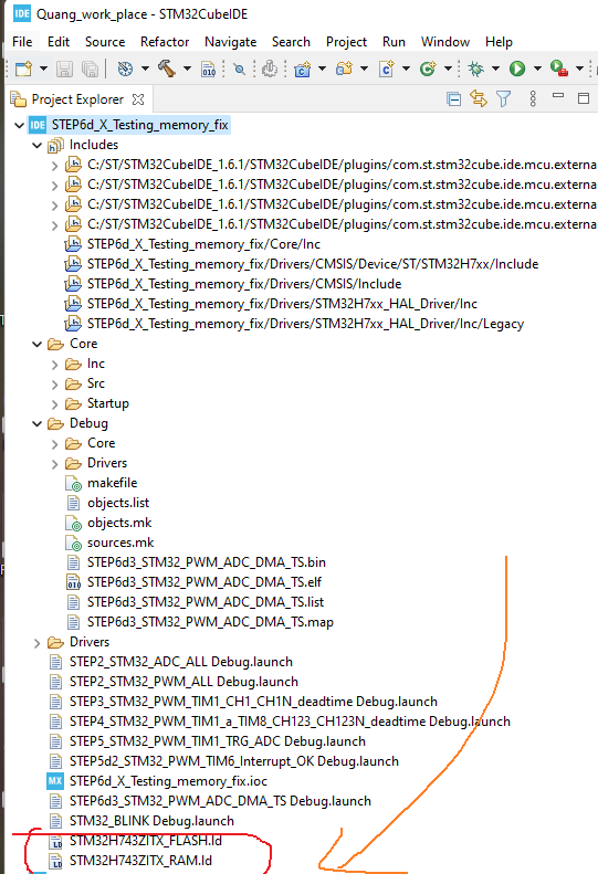

=>Question 1: there are two .id files one is flash one is Ram. -> I think that we need to change all (it depend on your programming method - store in FLASH OR RAM )
STM32H743ZITX_FLASH.id and STM32H743ZITX_RAM.ld

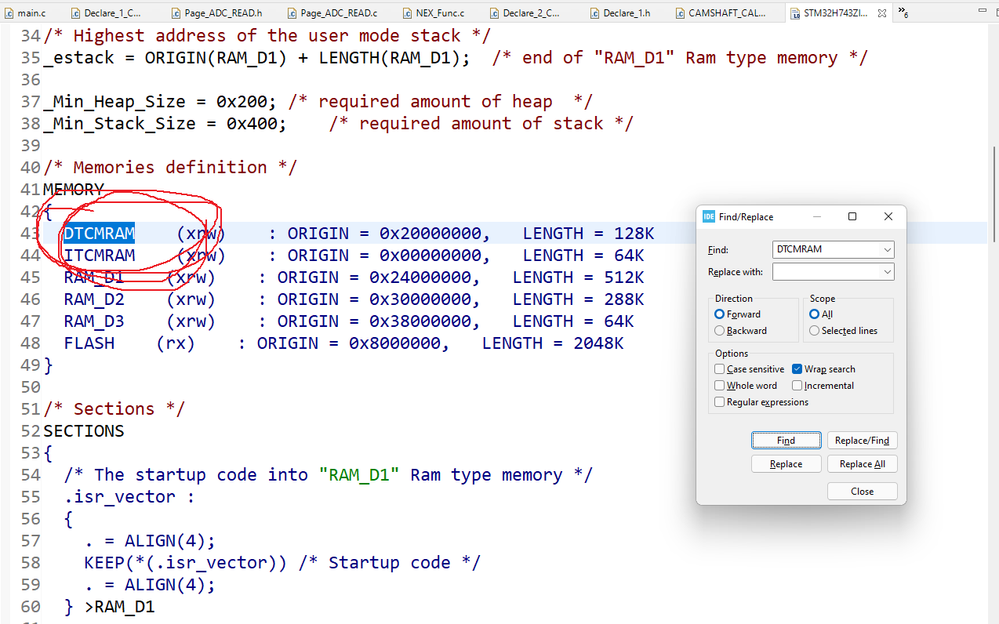

"Replace DTCMRAM with RAM_D1 " is not clear. In my case, it is hard to know which one to modify ???
For example , does it mean ? we should replace " DTCMRAM  (xrw)  : ORIGIN = 0x20000000,  LENGTH = 128K" with " RAM_D1 (xrw)  : ORIGIN = 0x20000000,  LENGTH = 128K" ???

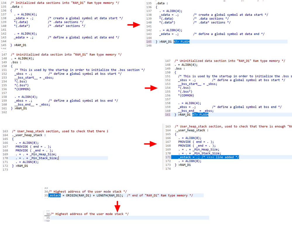

DO you mean that we should modify like this
 .data :
  . = ALIGN(4);
  _sdata = .;    /* create a global symbol at data start */
  *(.data)      /* .data sections */
  *(.data*)     /* .data* sections */
  . = ALIGN(4);
  _edata = .;    /* define a global symbol at data end */
 } >RAM_D1 AT> FLASH
.bss :
  /* This is used by the startup in order to initialize the .bss section */
  _sbss = .;     /* define a global symbol at bss start */
  __bss_start__ = _sbss;
  *(.bss)
  *(.bss*)
  *(COMMON)
  . = ALIGN(4);
  _ebss = .;     /* define a global symbol at bss end */
  __bss_end__ = _ebss;
 } >RAM_D1 AT> FLASH
 ._user_heap_stack :
  . = ALIGN(8);
  PROVIDE ( end = . );
  PROVIDE ( _end = . );
  . = . + _Min_Heap_Size;
  . = . + _Min_Stack_Size;
_estack = .; /* <<<< line added */
  . = ALIGN(8);
 } >RAM_D1
Question 4:
quote : "and remove the original _estack definition."
_estack = ORIGIN(RAM_D1) + LENGTH(RAM_D1); /* end of "RAM_D1" Ram type memory */
/* <<<< line Delete ???*/
do u mean we should delete this line?
Question 5:
finally, we disable Dcache in stm32CUBE, I am right? :D

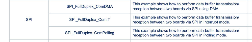

There are many examples for H7 SPI, just download stm32CubeMX.
https://www.st.com/en/embedded-software/stm32cubeh7.html
AP Note:
AN5033
Application note
STM32Cube MCU Package examples for STM32H7 Series
See:
The FLASH linker script is used by default. You should just delete the other one to avoid confusion.
=>Question 2
Don't touch what you have circled here. Follow the previous picture for what to replace, you circled it in your previous picture.
Question 3:
Delete the RAM linker script.
Question 4:
Yes.
Question 5:
Yes

In a nutshell, here's what I changed, ​(see the attached picture)
Please check if I'm doing it right? "Replace DTCMRAM with RAM_D1 for section placement in linkerscript (.ld file extension). "
